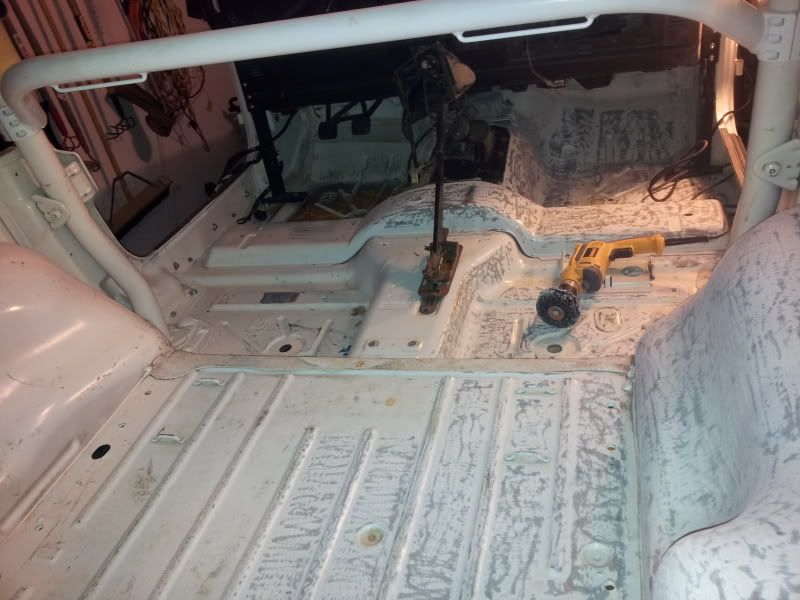

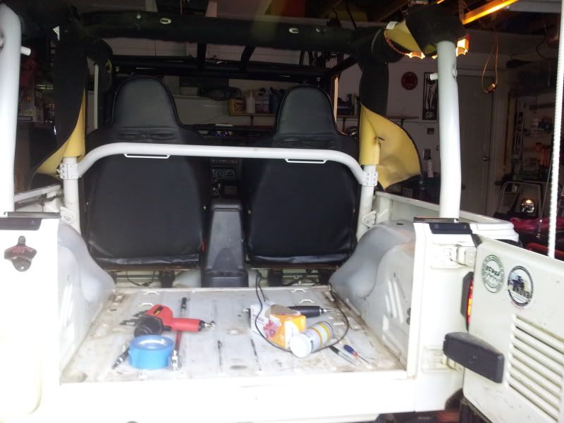

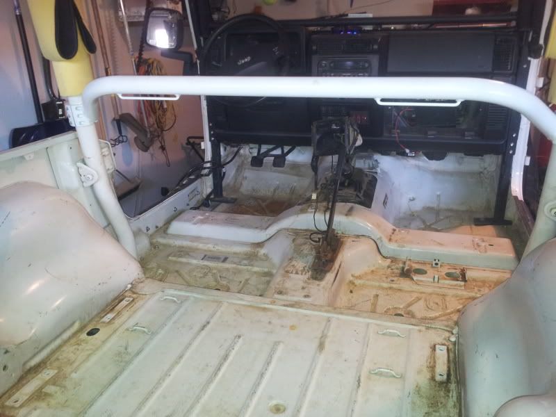

First things first. Strip EVERYTHING out.
You can still see mud in some of the cracks and crevices from past trips.
A good scrub down with a hose, soapy water and a scrubby brush will remove most of the dirt.
Next step is to prep the surfaces that are to be sprayed.
I chose to use a paint stripper/rust remover to take care of the rust on the floorboard and to strip the paint.
This may have been a little overkill as the directions say a 80 grit sandpaper would suffice but it was significantly easier and faster.
After I finished "sanding" I wiped everything down really good with some acetone to remove the contaminates.

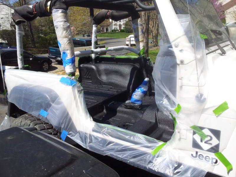

Rolled the Jeep out of the garage into the driveway to finish the last step of the prep.

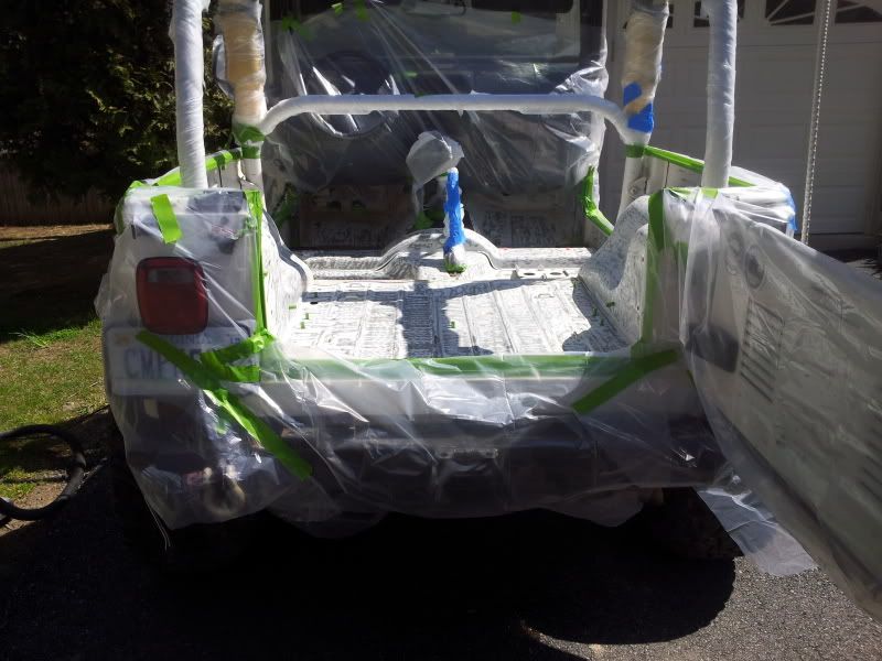

Taping off the edges I used some high quality painters tape and heavy plastic to drape.
Earplugs work great to fill in bolt holes! I didnt have enough though so I just rolled painters tape into cone shapes and shoved it in.
With everything taped off, plastic draped over everything else that could catch overspray and all the bolt holes filled it is time to spray!

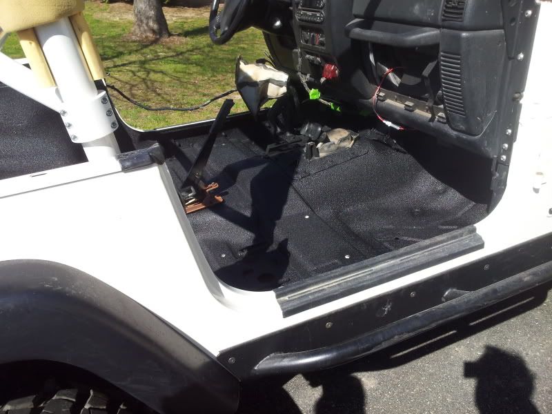

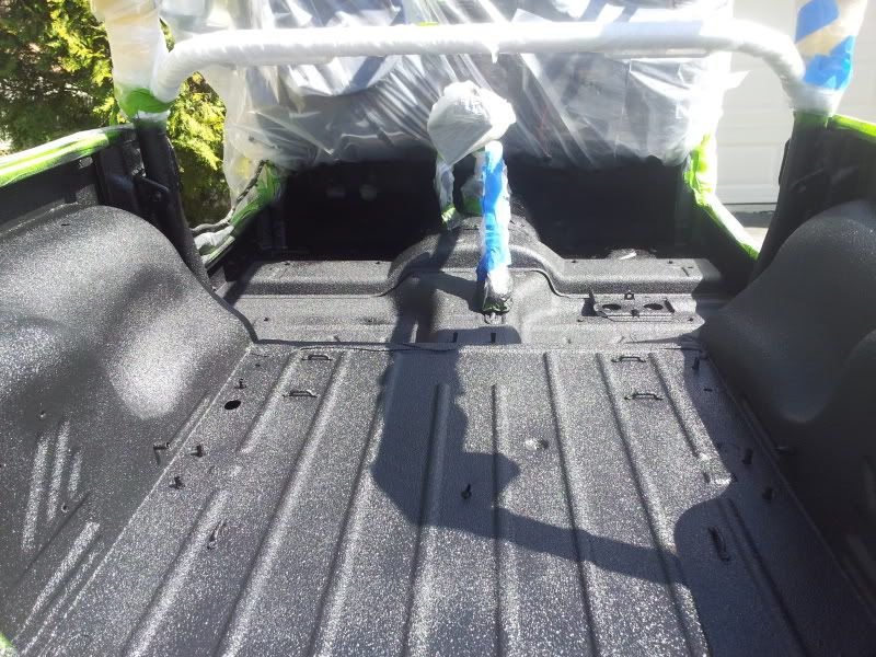

I used 3 of the bottles on the initial application. I sprayed the difficult areas first, ie behind the pedals up along firewall and the vertical surfaces.
I used the fourth bottle as a finish/touch up coat. Waiting one hour between coats and spraying over everything again to get a even finish coat and thicken up the high traffic areas.
This stuff is really hard to get off your hands so I would recommend a pair of gloves when spraying.

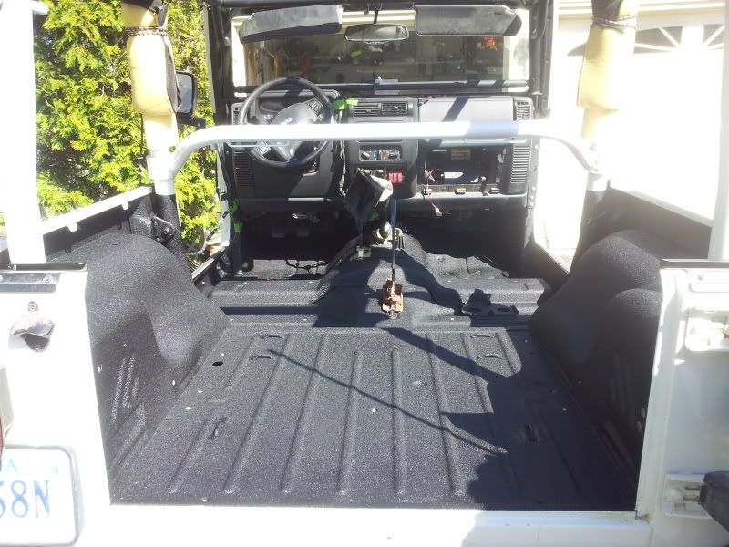

I waited another hour or so to give the liner time to thicken up and started to remove the tape and plastic.
It was kind of like unwrapping a birthday present.
I recommend keeping a little product from the last bottle.
As I unwrapped and peeled away I did find two spots that needed additional spray.
I left the Jeep out in the sun for the rest of the day, covered it with a tarp last night, and am leaving it out again most of the day today to help the liner cure properly. Plus it still has a really strong smell.
The instructions say light duty after 2-3 days and normal use 5-6 days later.
I will be reinstalling the interior mon or tues and will post more pics of the finished product.
Overall I am really impressed with the Raptor Liner. It applied really easy and looks great!
